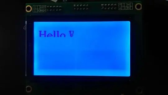

This gives a bit of a disappointing greeting as in the picture below. It seems that the Arduino is not accessing all the pixels, and only able to change the states of three blocks (the top one with "Hello V", and the two darker regions at the bottom).
That's supposed to say "Hello World"

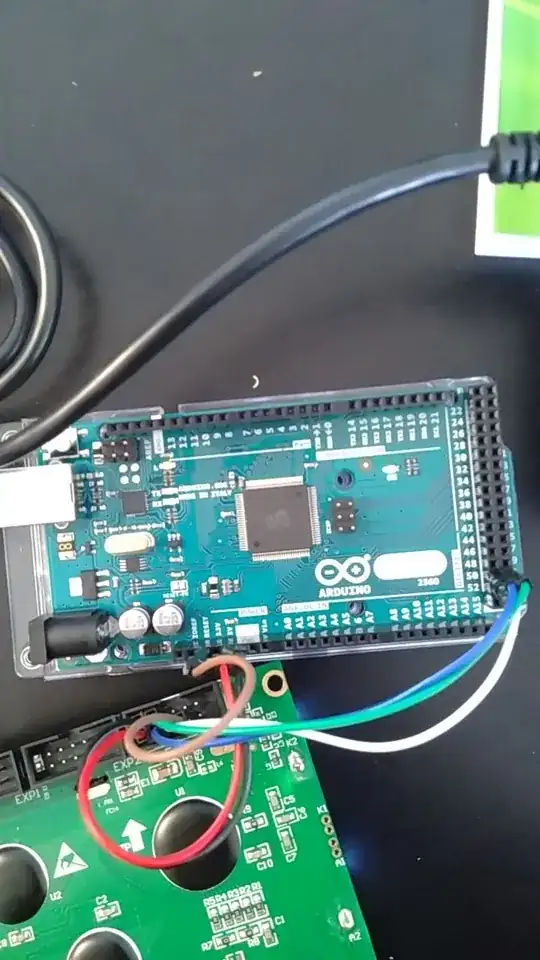

Wired up
The display is a 128X64ZW-10 salvaged from a 3D printer which was working when connected to the printer's motherboard. Pin-out deduced by some kind folk here and here (translation). I briefly saw random Pinyin characters flash across the whole display while I was switching wires. These two facts, and the fact that the regions of pixels that are working are not arranged at random, makes me suspect it is a wiring or coding issue, and that the pixels are not dead.
