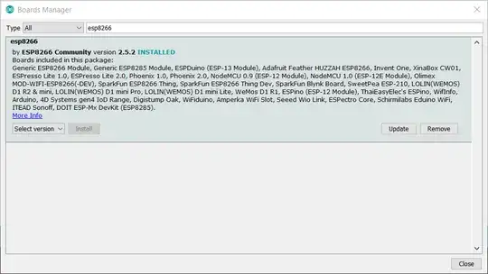

Finally I figured out a solution. I downgraded the ESP8266 board version in Arduino Studio to 2.5.2 and it worked. enter image description here

Thanks for posting the question and the solution. I spent hours on google and reading message boards before coming across this. I am not sure if my root cause was the same, but to me the "strange" IP for my ESP8266 (nodemcu) came from them connecting through the Guest Network of my Asus router. This resulted in an identical problem to OP with complete random connecting and long duration of no connections to WiFi, Internet and Blynk
Reverting back to ESP8266 2.5.2 in Arduino Studio seems to have magically solved the issue. Someone should alert the makers of the library.
