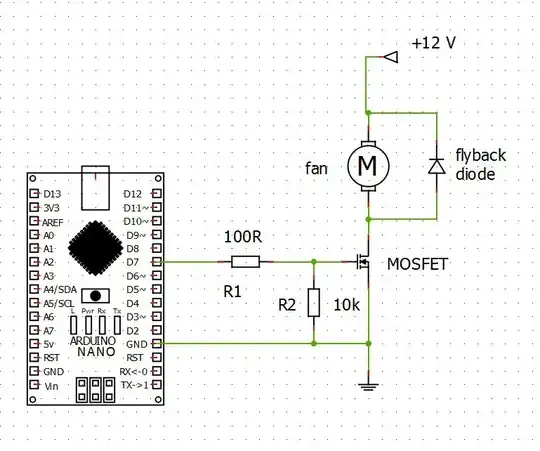

I advice you to learn about basics of how to connect external components to MCU. Anwser to your question is simple transistor amplifier... So you can use bipolar transistor (NPN/PNP) or MOSFET... MOSFETs is better for switching like your case, switching via PWM.
If you switching inductive load with MOSFET like motors or coils, don't forget add antiparallel flyback diode. Otherwise your MOSFET will burn out. How to connect mosfet to arduino pin

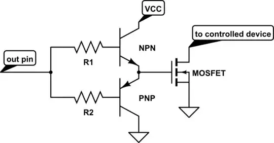

If you need switching with higher frequency or load with more voltage or power I advice to use push-pull logic to drive mosfet gate.
Something like this:

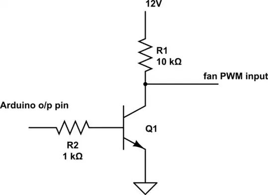

As far as I can tell the Arduino does not have open collector outputs, so you can mimic one as follows. The following inverts the Arduino output signal, so some adjustment is needed there when generating the PWM signal.
Excuse the rather gross schematic. I can't find any scaling parameters.
The particular resistors values are not terribly important, mainly to limit current.

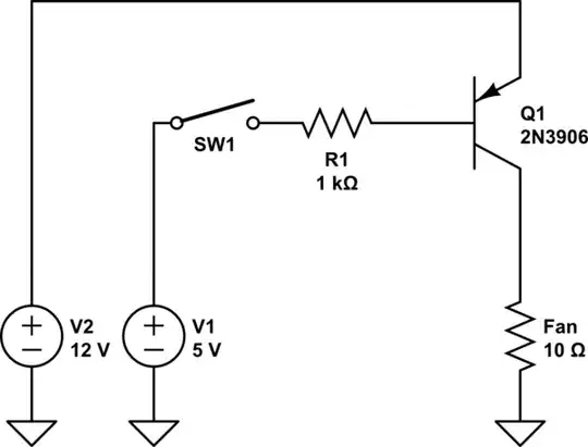

You'd usually use a transistor to do that.
schematic
SW1 is your microcontroller creating the PWM signal.

I've upvoted @Sahasrar's answer. If you haven't taken a look at it, you should. It fits squarely into this "Option 1" category.
However, in his first image, when controlling pin D7, the MOSFET gate is actively driven both HIGH and LOW with a max (initial) current of I = V/R = 5V / 100 Ohms = 0.05A = 50mA, which is good, but kind of weak (a good MOSFET gate driver is more like 500~1000mA drive current). This is also exceeding the 40mA max current rating of the Arduino pin, so I recommend you choose a slightly bigger resistor. The resistor here is to limit current to not damage your Arduino pin when charging and discharging the Gate capacitance of the MOSFET, which capacitance is significant enough for MOSFETS (but NOT BJT transistors), that it is even listed as a parameter in a MOSFET transistor datasheet (but not in a BJT transistor datasheet). WithOUT this Gate resistor, each time you drive the Gate HIGH or LOW, you'd otherwise have the equivalent of a momentary instantaneous short through the Arduino pin, which could damage the pin.
Also, you have to be sure to use a Logic-Level N-Channel MOSFET which can be driven with a gate voltage as low as 3.3V~5V instead of requiring more like 10V~12V.
So, with @Sahasrar's first circuit, the max PWM frequency you can use is probably a few dozen kHz.
If you need to drive higher PWM frequencies, the solution is to use the push-pull logic circuit which @Sahasrar shows next instead. But, you have to fill in the blanks: choosing parts, doing calculations, having advanced knowledge.
