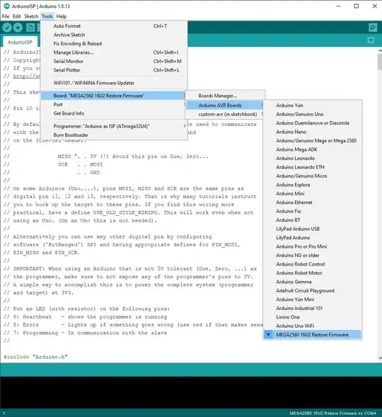

The bootloader on the 2560 is uploaded by using an Arduino Micro via ArduinoISP. I followed this tutorial from Instructables on uploading the bootloader/firmware for the 16U2 except I modified some parts for the 2560 instead of the UNO. Here is my added section in the /program Files (x86)/Arduino/hardware/arduino/avr/boards.txt
unorestore.name=MEGA2560 16U2 Restore Firmware
unorestore.bootloader.tool=arduino:avrdude
unorestore.bootloader.low_fuses=0xff
unorestore.bootloader.high_fuses=0xd9
unorestore.bootloader.extended_fuses=0xf4
unorestore.bootloader.file=Arduino-COMBINED-dfu-usbserial-atmega16u2-Mega2560-Rev3.hex
unorestore.bootloader.unlock_bits=0x3F
unorestore.bootloader.lock_bits=0x0F
unorestore.build.mcu=atmega16u2
unorestore.build.f_cpu=16000000L
unorestore.build.board=uno.build.board=AVR_MEGA2560
unorestore.build.core=arduino:arduino
unorestore.build.variant=standard

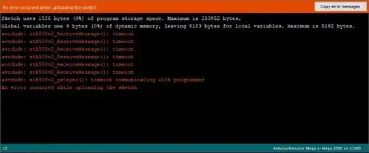

The problem is after I upload a sketch (with a size say over 10 kB), I can't upload any new sketch and get this timeout error message instead as shown below. Not even a simple blink sketch. The TX and RX LED connected to the 16U2 uC that flashes during an sketch upload doesn't even blink once.
The only way I can get it take another sketch is to "re-flash" the bootloader on the 2560 uC via ArduinoISP. The TX and RX led now flashes during the sketch upload. Of course, this is a huge hassle as I don't want to do "re-flash" the 2560 bootloader every time I want to upload a sketch.
I don't have this problem on my Elegoo Mega2560 R3 clone board so I'm thinking it might be something wrong with my 16U2 firmware/bootloader. Anyone have any idea what else might be causing this?
