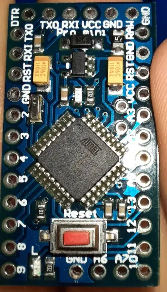

Sergio, yes, you can probably/perhaps save it: your Arduino (the microcontroller--ie: processor at least) is likely just fine, assuming the linear regulator smoked and failed open, meaning it did NOT pass through the raw input voltage to your ATmega328 mcu. It's the linear voltage regulator that is fried! That's this circled component below:
So, desolder that part and throw it away and you can continue using the Arduino just fine. Just power it with a regulated 5V directly to VCC is all and you'll be fine. I've done exactly this on some parts I exploded or smoked the regulator on (see below), and they continued working just fine.

  1. Desolder the voltage regular (circled in the image above, and shown desoldered on my Pro Mini in the photo below) and throw the desoldered voltage regulator away.

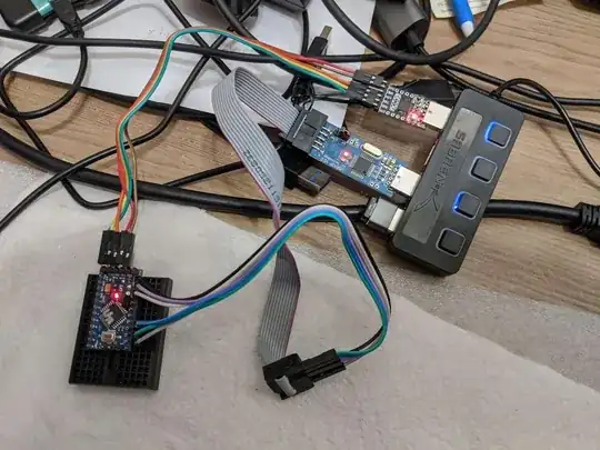

  3. Reflash the bootloader with a USBasp programmer (shown in 2nd of the two photos below).
  4. Upload a new blink sketch via the external USB serial UART to blink the built-in LED13. This works fine on my Pro Mini below shown with exploded and desoldered regulator:

  5. Unplug the USBasp programmer when done, and continue development with just the external serial UART plugged in.

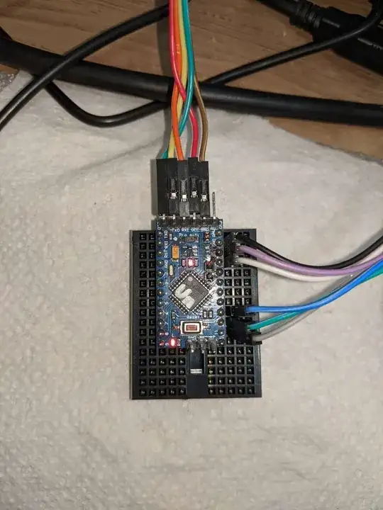

Here's some photos of my Arduino Pro Mini with exploded voltage regulator that I desoldered. I found it today. The Arduino still works fine! I desoldered the regulator around the year 2014 or so, but just re-flashed the bootloader, uploaded the code, tested it, and took these photos today:
Image 1: Arduino Pro Mini used as a data-logging altimeter in ~2014; photo from today. The voltage regulator exploded (read below), so I desoldered it. Both the power LED (top center of board), and LED13 (bottom-left of board) are ON. The power LED comes on automatically so long as you are powering the board through Vcc and GND from your USB port through your USB UART adapter, and the LED13 is blinking ON here due to the blink sketch above AND by powering the board with Vcc and GND from the USB serial UART to the Pro Mini. Note that the LED13 would NOT light up properly with just the USBasp plugged in, even when it was properly powered and programmed by the USBasp. I think it's because the USBasp was interfering with that pin. Plugging in the external serial UART to the Pro Mini's Vcc and GND fixed that, allowing LED13 to function properly as well while the Pro Mini ran the blink sketch above.
Image 2: External USB serial UART (in the USB hub top port), USBasp programmer wired to program the bootloader (in the USB hub under the USB UART), Pro Mini (bottom left) with power LED ON and LED13 (bottom-left of board) OFF.

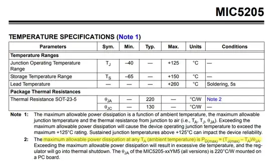

By the way, looking at the Pro Mini schematic here, I see that the original board used a MIC5205 linear regulator. The Chinese clone you have certainly uses a different regulator, but let's look up the MIC5205 datasheet for benchmarking purposes. A google search for "mic5205 datasheet" leads me here: https://ww1.microchip.com/downloads/en/DeviceDoc/20005785A.pdf. The device is rated up to 150mA current and up to +16V input voltage, but you must consider power!
The equation for that is hidden on pg 5 here:
Power_dissiplation_max =  P_D_max = (T_J_max – T_A)/theta_JA
theta_JA = thermal resistance from Junction to Ambient = 220 degC/W
T_A = ambient temperature = let's say, 40 deg C (104 deg F)
T_J_max = max junction (internal chip) temperature = +125 degC
So, we crunch the numbers:
P_D_max = (125C - 40C)/220 C/W = 85C / 220 C/W = 0.386W = 386mW max
power.
Final result: this tiny, linear voltage regulator, assuming absolute max junction temperature of +125 C (257 F) [HOT HOT HOT!--not good] and ambient air temperature of 40C (104 F) can dissipate 386mW max power before you risk making it go "pop"!

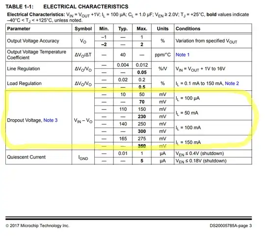

So, use a lower input voltage and you can draw much more current! How low can you go? Don't go lower than 5V + dropout voltage. The datasheet on p3 for this regulator shows a max dropout voltage of ~350mV, so stay > 5.35V input to get a regulated 5V output.
