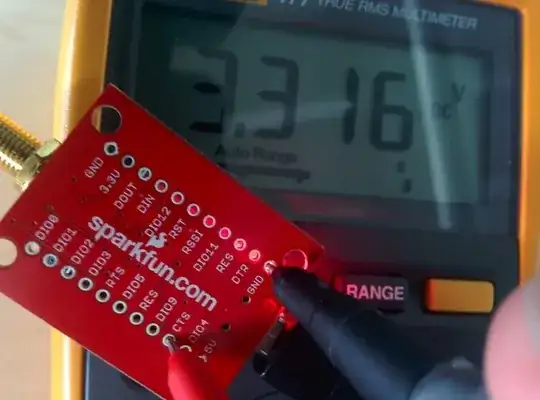

I used a multimeter and discovered that the XBee PRO S2B CTS / DIO7 port is high, while the one from the XBee S2 is low, and so constantly resetting the arduino. I mounted the XBee PRO S2B onto the Sparkfun XBee Explorer USB and opened a serial port with PuTTY. In contrast to the S2, the PRO S2B provides a menu with several options:

Sparkfun XBee Explorer USB, CTS port
As soon as I type B, the CTS port goes low, and would prevent the arduino from resetting. Also this mode is needed to detect the module via XCTU. However, with an unmodified arduino, I wouldn't have a chance to send this letter, since the XBee is constantly resetting it. What is this menu, can it be disabled somehow?
