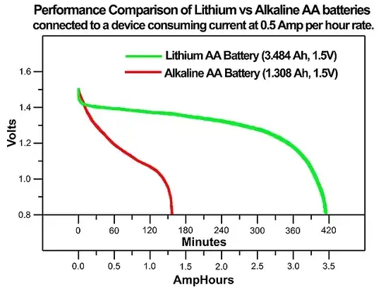

AA Battery
Above is an AA Battery voltage curve. Many people assume that 5* 1.5V AA batterys would be enough to power the Arduino. As you can see the 1.5 is the maximum voltage and it quickly drops. Different brands have different values and sometimes this can drop below the value of the voltage regulator input. I usually tend to aim between 7 and 9 Volts for running from batteries, ie the nominal voltage of the batteries, eg 6 x 1.5V = 9V.
For wall socket charges, Buy a cheap one and hook it up to a volt meter, Many that say 5V actually have a range of values. Raspberry Pi users often have problems with power caused by manufacturers saying its 5v and it actually delivering something like 4.85 and fluctuating beacuse of the power demand of the pi
