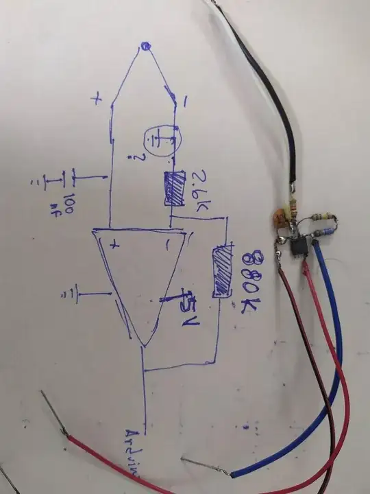

first of all I have to say that this is my first Arduino thing. I'm trying to connect a k-type termocouple to my Arduino using an LM2904 Oamp, Yes I know that this is not the best solution but is the only that I have right now due to the pandemic situation, that I can't get a dedicated module as an MAX6675
This is what I have done:
enter image description here note: The Grnd symbol next to 2.6k resistor is a handwritten error, its not connected in the circuit
my problem is that with this circuit I'm having 3.7V on the arduino analog input even before connect the termocouple. After connect it, the read is about 2.6V and it starts to increase as expected when heat is applied.
My problem is if I have 2.6V for 32°C for temperatures over 200°C I will have more than 5V. Any help with this?
