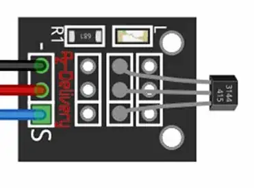

I have a small project where I connected a Hall sensor (see picture) to an Arduino Mega. The blue wire is connected to pin 45, the red wire to +5V, and the black wire to GND.
Hall-Sensor AZDelivery KY-003

I haven't found the problem yet, but I have come a step closer. The issue has reappeared in a similar project on the same Arduino. I use a new Hall sensor with pull-up, which is read out wrong again under certain circumstances (always read out as LOW, no matter if a magnet is nearby). The problem seems to occur only when I use a certain pin. The pin in question on my Arduino Mega this time is pin 37. If I connect the Hall sensor to another pin (I have tested 34 and 36), it works fine. If I connect a previously working Hall sensor to pin 37, it will not work anymore (always evaluated as LOW). The only explanations that make sense to me at the moment are that either the Arduino Mega is damaged or that there are side effects, maybe caused by external libraries using certain pins without my knowledge and incorrectly initializing them.

The 3144 requires a pull-up resistor. It only sinks when a magnet is present. It doesn't source, so the pin is floating if no magnet is present.
You can use the internal pull-up resistor by using pinMode(HALL_PIN, INPUT_PULLUP);
