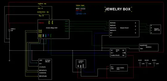

enter image description hereProblem is if I open the necklaceDoor first, nothing happens. I have to open the ringDoor first. That turns everything on. Then with the necklaceDoor open, the stepper motor will turn off and the lights and music will continue to play. But I want to be able to open the necklaceDoor first and play the music with the lights. I do not want it to matter which one is opened first. I also realized that if I can get an or statement to work within an and statement I could do away with the fourth if statement completely. Both ringDoor open and necklaceDoor open, as well as ringDoor closed and necklaceDoor open have the same outcome. Now if I switch the door states in the third if statement, I get necklaceDoor only plays audio after closed(original problem) but if both doors are open and then ringDoor is closed, the music will shut off after the stepper timer is done and then start again after necklaceDoor is closed?!?!?!?

First of all, you have to find out how your magnetic switches work. Are they opened or closed if you attach a magnet to them? Do they behave the same or is one closed and the other opened if you attach a magnet? Your code above is written for active LOW switches i.e. if the respective door is closed the switch is opened and therefore the logic level of the pin is HIGH. The level is LOW if the door is opened (activated; hence active LOW).
In order your code had a chance to work, the switches must be connect the right way: on one side connect them to GND and on the other side to the respective Arduino pin. If this is not the case, the code must be changed or the switches must be conneted the right way. You did not show us your schematic, so I can not check it for you.
Here is some code to try: But first find out if the switches you use are LOW or HIGH active. I also have no access to an IDE at the moment, so I can not try out the code. Take it as a hint on how to do it.
