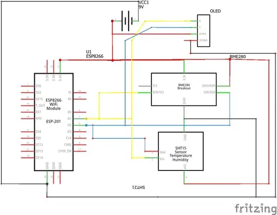

I have connected two temp sensors and an OLED display to a NodeMCU using I2C. When the program reaches the instruction to print the measurements on the display the program crashes and NodeMCU resets itself. In the serial monitor I see "rst cause 2". I did search about this online but couldn't find a similar issue involving an OLED. I wonder what is causing this reset and how to fix it?
