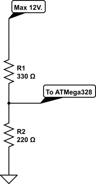

I was doing some Ohm's Law calculations to calculate the voltage output from a 2-resistor voltage divider, the input will be with a maximum of 12 volts, I want the ATMega328 to measure that voltage, so I simply thought of putting two resistors in series with values of 330 ohms and 220 ohms like this:
schematic
Theoretically on paper the maximum voltage outputting from the node going to the ATMega328 is ~4.8V, but I want a special safety feature, I want to put in mind that at anytime the ground connection can be hung open (to simulate a lose breadboard connection, bad soldering joint etc...) now based upon my understanding if there is no ground connection, the voltage going to the Arduino will be 12V which is a killer, as after looking on the ATMMega328 datasheet it states that
28.1 Absolute Maximum Ratings. Voltage on any pin except RESET with respect to ground => VCC + 0.5
The current will be limited by the 330ohm resistor to only 36mA which I think is a lot, I thought of doubling the resistors values to 330000 and 220000 by that the current will be limited to only 36uA. Again based upon my understanding there is still 12V going to the Arduino but wouldn't it directly drop if the ground connection was cut off ? That's why I ask what is the maximum input power to an Arduino?

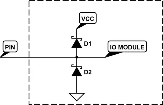

This is actually a special case that is undocumented, and in fact not as simple as you would at first think.
The input port itself is not actually what is in question here. Instead every IO pin on the Arduino, be it set to INPUT or OUTPUT, has a set of ESD protection diodes on them. These look like this:
schematic
The "IO MODULE" when in INPUT mode can pretty much be ignored, since it is a very high impedance. Just like a (roughly) 10MΩ resistor to ground. Very very little current will flow that way.
D2 is also reverse biased so that direction can be ignored.
So the current will want to flow through D1 to the VCC rail (+5V). The diodes have approximately a 600mV forward voltage (which is where the VCC + 0.5 comes from).
So we can recalculate, given those parameters, what the current flowing through the diode will be to the 5V rail:
  • Voltage difference = 12V - 5V - 0.5V = 6.5V
  • Current = V/R = 6.5/330 = 19.7mA
The recommended maximum (from what I can gather) is only 1mA. You have 20x that.

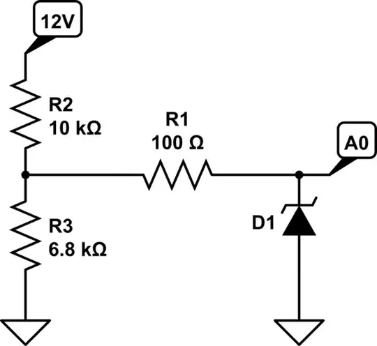

So you will need at least 20x higher resistances. 10kΩ in the upper half and 6.8kΩ in the bottom half. That will give you 4.85V on the output at 12V and limit you to 0.65mA in a failure situation.
It also gives you an output impedance of a little over 4kΩ which is below the recommended maximum of 10kΩ for the ADC input.
You can further protect your input by adding a 5V zener diode and small series resistor on the ADC pin so if the voltage goes above 5V it clamps it and protects the pin.
