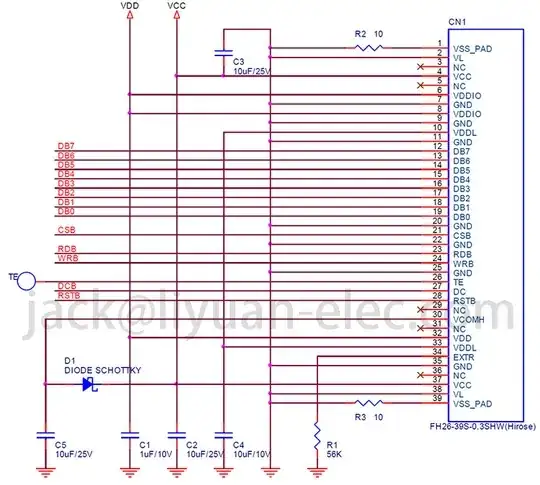

A long time ago I ordered this transparent OLED display (from a chinese supplier on alibaba) planning on interfacing it with an Arduino but didn't really have the skills to get the project going.
I have the datasheet (linked below) for the driver and it seems to come with a schematic on it which takes the output from the OLED and gives me 8-bit wiring. My plan is to use the adafruit GFX library with it and probably steal the code from this adafruit TFT.
Please, someone tell me if this has no hope of working but my plan as it stands is:
1) draw up the datasheets schematic into Kicad, and get it printed onto a PCB (I am worried that if I breadboard/protoboard it, ill have all kinds of issues coming from my poor perfboarding skills and I want to be able to narrow down my problems. I know it's bad practise to print a PCB before doing any breadboarding but I don't think ill successfully manage it)
2) wire up the output pins from the new PCB in the same way that the adafruit board and try and use the same code.
3) Here are where the problems come I think as I am proficient at simple code (I'm probably being ignorant to the fact that 'simple' code is still way above my level) e.g functions/loops etc... but writing code like adafruits example for displays is way above my level. I hope that I can just edit some of Adafruits existing example code and it will just work.
A few years ago I asked a similar question on the Arduino forum but then I was much worse at programming and had less of an idea where to start.
If any of you can provide insight into if this will work or any better ideas then I am all ears.
Thanks
Documents containing datasheets and example code - https://drive.google.com/drive/folders/1ZTmipJKRKWNMudYVQ5ATxixbQtKD4hQm?usp=sharing
Schematic Provided

jsotola
  • 1,554
Is the SPI communication method feasible? I have found a chip at present, and it seems that the driver can be transplanted directly. You can look at this chip. https://nl.mouser.com/ProductDetail/Newhaven-Display/NHD-169-BREAKOUT?qs=wnTfsH77Xs6v7mYjAGElxw%3D%3D
Damon
The critical part, assuming your hardware works, is getting the software going. Not all OLEDs are the same, and different ones need different commands to get them working.
You can't just take a random OLED and use a random library - it needs a driver to make it work.
In this case it's the DA8620 that is the main chip that you want to worry about, and your chosen library has to implement the commands and methodologies for that specific chip.
Now, you have a file that contains those commands (all the "hex commands"), and if you can't find an existing library to work with the DA8620 then you will have to write or adapt one while referring to those commands. You can find out more about what the commands all mean by referencing the datasheet, which lists all the commands and their parameters (from page 78 onwards), so you should be able to relate those to what an existing library needs and map things accordingly while keeping the right power-up sequences.
