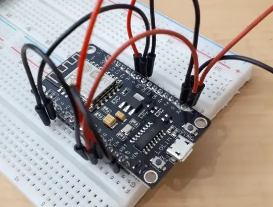

Yes, you may connect all 3V pins together (red) and all GND pins together (black), like so:
In some cases, more wires will improve the circuit. E.g. when you build the Ben Eater 8-Bit CPU, you'll find that connecting power in a ring instead of a line will reduce voltage drop by about 50%.

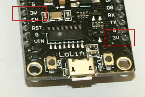

If you have regulated (stable) 3.3V already, you can connect that to a pin labelled 3V:
Also, you need to connect the grounds (GND) of both circuits together (GND of external board to GND of NodeMCU), otherwise the current will not find its way back.
