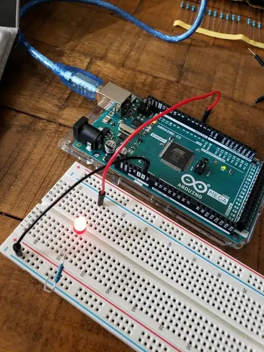

I have an Arduino MEGA 2560 and a red LED connected to pin 4.
#define RED 4
#define GREEN 2
  analogWrite(GREEN,  0);
  analogWrite(RED,  100);
This code lights up the red LED. led on However, when I write 1 to the GREEN pin analogWrite(GREEN, 1), the red LED goes off. I'm expecting the red LED to stay on.

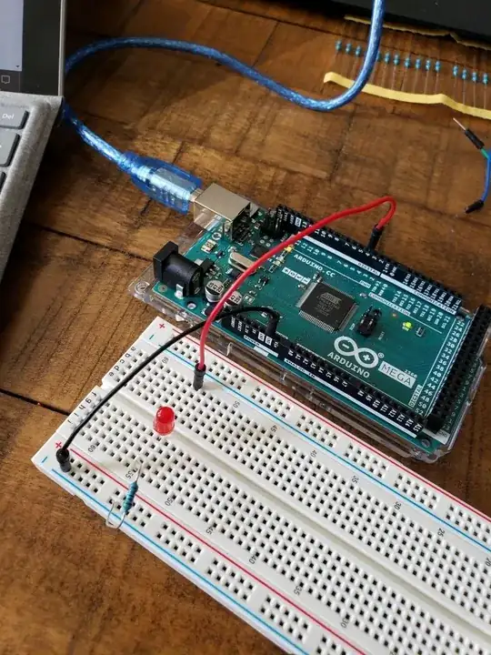

  analogWrite(GREEN,  1);
LED off

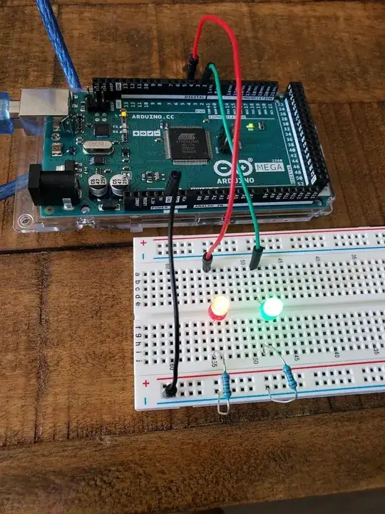

  analogWrite(GREEN,  100 + r);
  analogWrite(RED,  50 + r);
two leds on
