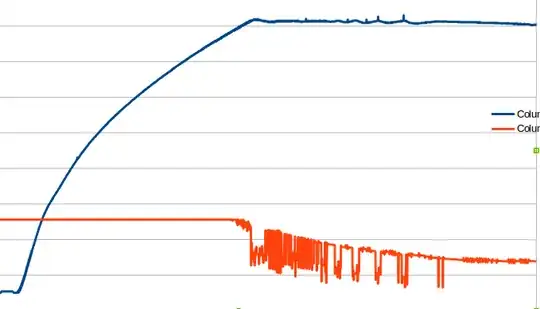

EDIT 4: the PID outputs high values for high power and small values for lower power. but the Triac period is the off time. so the period should be something like period = 11000 - (75 * output)
here are the input and output values of mike's code based on this answer (blue is temperature, red is output for the Triac period):
The PID control gets smoother over time as it finetunes its parameters, but I think a simple PID has some problems with the sine relation between the output (time) and the resulting heating power.
