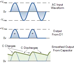

It's really important to realise that most low-cost DC power supplies are not regulated and produce a very bumpy output voltage with no regulation:
Tantalums also have no tolerance for reverse voltage, so if you did apply reverse voltage, it would pop.
So it is quite likely that you over-volted the cap and blew it. You could replace them with higher rated capacitors - I would go for 35V ones if you want to supply 15.1V. Desoldering and desoldering a single capacitor is relatively easy as long as the pads haven't been damaged. Realistically, you could use a normal leaded 10uF electrolytic between RAW and GND instead of the SMD one.

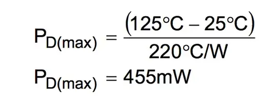

The MC5205 can dissipate 455mW with a minimal PCB footprint (which the Pro Mini has) with a 25°C ambient:
Thermal calc
So, we know the maximum power we can dissipate, and we know the voltage drop - we can then calculate the current:
P = (Vin - Vout) * I
0.455 / (15.1 - 3.3) = I
I = 38.5mA
This isn't very much at all. You might want to consider regulating off the board, and probably with a switching regulator rather than linear regulator.
