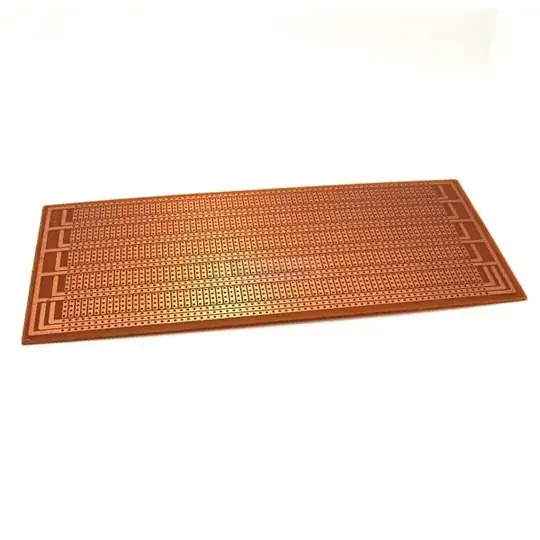

  1. The custom PCB: Breadboards are good for experimenting, but not for a finalized circuit. Depending on some factors you can decide between multiple options. One, that I myself often use, is soldering the parts onto a perfboard. That are cheap PCBs, where - depending on the type - you have a grid of single through-hole solder pads or connected groups of through-hole solder pads. I like to use these:
    perfboard with conveniently connected pads
    The pads are connected nearly like a breadboard, so it is easy to use with Arduinos and such. You can build your circuit on there by soldering the parts to it, and make the PCB the right size by cutting it into the needed size.
