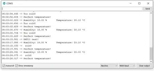

So my project is including detecting the temperature in the room by using dth11 sensor. my idea is to add 3 LED lights were each light represent the temperature if its cold or hot or perfect.
the wiring and coding is done and it's working .However, i'm having a problem were the perfect temperature is always on no matter if the temperature is hot or cold. example: if the temperature is cold the cold LED will blink and the perfect temperature LED will be on.

Faisal
firstly, move your pinMode() settings to setup section.
in your code, when the temperature is 21 active pin will be 6 and 8. you should rewrite your code in next ways:
1:
if (t < 22) {
  ... its cold temp ...
} else if (t > 26) {
  ... its hot temp ...
} else {
  ... it's nor temp ...
2:
if (t < 22) {
if (t > 26) {
   ... it's hot temp ...
if (t >= 22 && t <= 26) {
and my small advice for u, rewrite in this way, it is more readable
digitalWrite(6, HIGH);
digitalWrite(7, LOW);
digitalWrite(8, LOW);
digitalWrite(6, LOW);
digitalWrite(7, HIGH);
digitalWrite(8, HIGH);
visually changing ENUMS (like LOW or HIGH) more noticeable than changing numbers (6/7/8)
