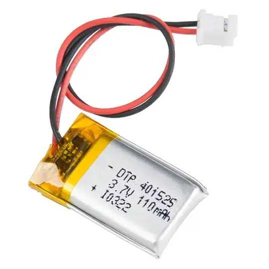

I have a small 3.7V Li-ion battery I'd like to use (similar to this one {0}) if possible.

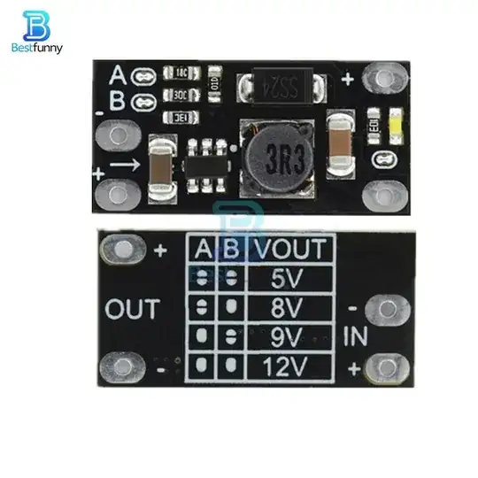

  • I could use a Step-up DC-DC transformer - like this {1}? I'd rather not wait for shipping from China.

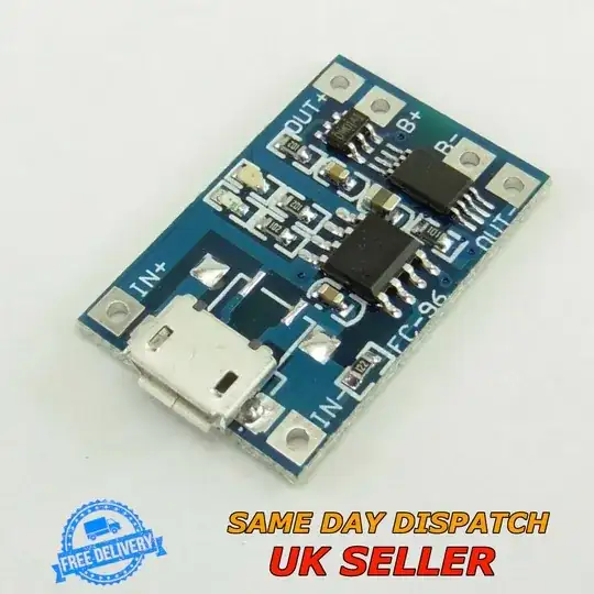

Furthermore, I'd like to be able to charge the battery, so if I use a charging board like this one {2}, would that just work?

0: Lithium Ion Battery - 110mAh
1: Mini 3V 3.3V 3.7V 5V 9V to 12V Step Up Boost Converter Module Voltage Regulator
2: 4.2V 5V 1A Micro USB Li-ion Battery Charger TP4056 Protection Chip Lithium-ion

Yes, if you provide more than 3.3V you are liable to damage the board (note that a Li-Poly can be around 4.2V when fully charged).
You need to take your battery power and feed it through a nice efficient switching voltage regulator that has a low enough "dropout" voltage to allow good use from the battery. Note that many devices "rated" at 3.3V will also work much lower. For example:
