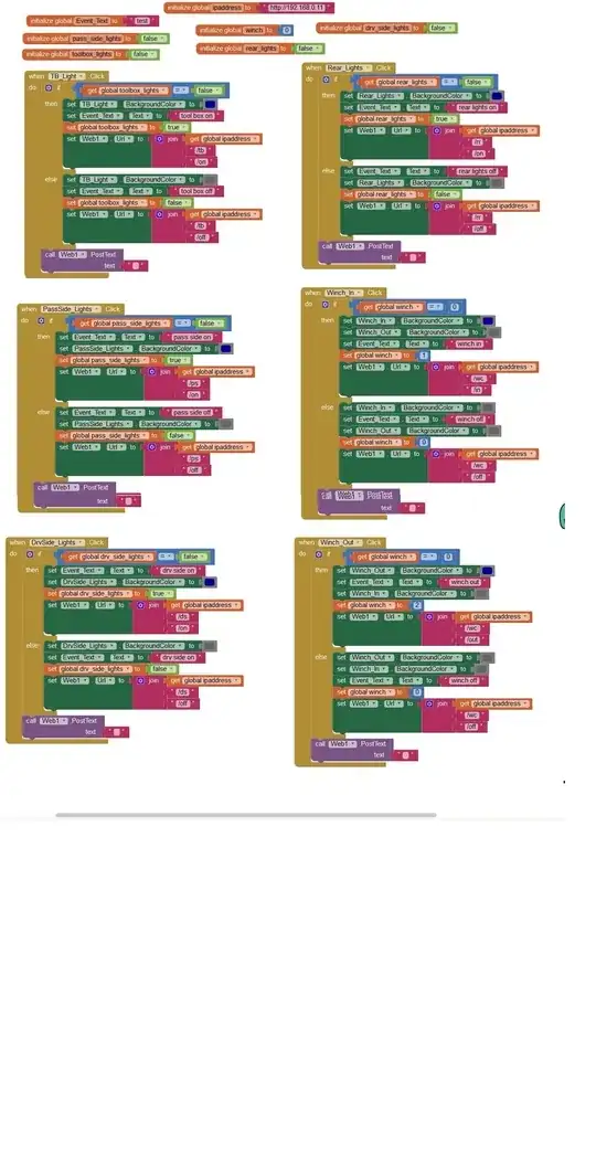

//    Serial.println("Client disconnected.");
//    Serial.println("");
Here's the blocks for the MIT App Inventor: enter image description here Each one of the blocks responds to a button press and depending on what the global variable is (upper left block is for toolbox lights) it will send the URL "/tb/on" in the case for turning the toolbox lights on. [Edit:] It works fine when I use the modem as an access point but I need soft access points because I don't want to have to carry a router around in my truck.
