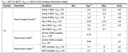

Looking at the datasheet:
copyright ATMEL
We see that current draw while waking up (running the bootloader) is probably going to be around 2mA, while sleeping current is about 0.8 microamps. This could certainly lead to a blackout on startup without the proper current.
Perhaps you should only turn it on with 5v power, or maybe you need a higher current, higher voltage battery.
