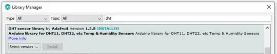

kwhunter
You have installed the Adafruit DHT library via the Arduino library manager
Adafruit library

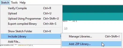

The source code does not work with that library. It is written to use the DHT library written by Rob Tillaart, named DHTLib. That library is not included in the Library Manager of the Arduino IDE. Instead, you have to download the library as a ZIP file and install it via Sketch / Include Library / Add .ZIP library.
How to install
I don't know why you have changed the source code in the meanwhile. Using DHTLib with the source code of revision 1 of your question works fine. In the meanwhile you have tried to adapt the code to match the Adafruit library, which eventually might be ok as well after some hard work. I suggest rolling back to the code of revision 1 and installing the correct library.
