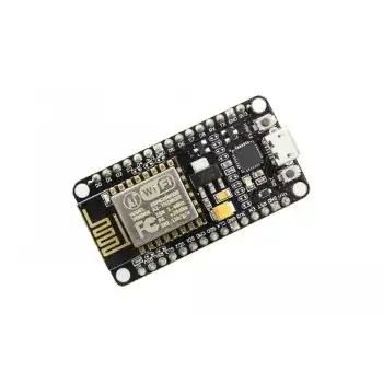

NodeMcu is a development board with esp8266 and a firmware with the same name. On the picture is a NodeMcu development board with an esp-12F esp8266 module soldered to the PCB of the NodeMcu. The development board adds required circuits around the module - boot configuration pull-up and pull-down and enable pin pull-up. On the board is an USB chip to connect the esp8266 to USB and an auto reset circuit to enable the upload tool to put the esp8266 into flashing mode. The 3.3 V power for the esp8266 is converted from the 5 V of USB.
The NodeMcu firmware is a Lua language interpreter and has nothing to do with Arduino, but the NodeMcu development board can be used as any other esp8266 development board.
