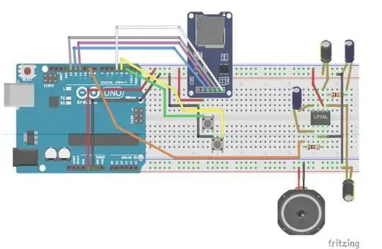

I'm struggling that my Arduino doesn't play music. Here is my circuit.enter image description here It proforms normally when I only connect this circuit to Arduino UNO. But when I change the whole circuit to Arduino Mega the music trues into noise. I've followed the tutorial to change the SD card adapter pin to the suggested pin.
Is there any possibility that the circuit is obstructed by servo motor which also connected to this Arduino mega? Here's my code.
