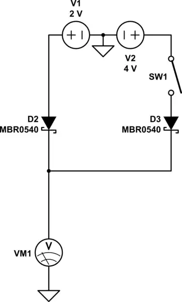

I am atempting to use the arduino and MCP4725 breakout board to inject 4 different voltages into an existing line that comes from V1.
V1 is the analog signal from an existing unit and varies between 2v, 3v and 4v. VM1 responds to those voltages and switches to a different working modes. 2v == Mode A, 3v == Mode B, 4v == Mode C.
My plan is to have MCP4725(represented as V2 below)hooked up to Arduino to simulate Modes A, B, C when needed.
MBR0540 D2 is there to prevent sending the voltage back to the sending unit, MBR0540 D1 is to do the same for DAC.
I am worried that if the D2 fails for whatever reason, I might loose the sending unit functionality.. is there a better way to do it?

Unless you are really stressing it, it is highly unlikely that D2 would fail.
You could, though, replace both diodes with a simple SPDT switch to select between the two voltage sources.
Whatever you do, though, it probably has about the same chance (or more so) of failing (and the same end result) as having the diodes.
You could always add an "emergency override" switch that both bypasses D2 and isolates V2 in case of failure.
