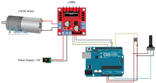

I am trying to get the L298N to work with a simple DC motor.
For now, I have simplified the setup and the code to the basics to try to get it to work. I am using the following wiring setup with no button or pot: enter image description here
Only 1 motor, I am using a 2S lipo which I measured the voltage to be 7.8V which should be enough. The DC motor works when directly powered from the battery and when power with ~5V from an Arduino so I know it is not the issue.

I can measure the voltage at the input, it is good 7.8V. No voltage on motor output pins. In1 has voltage of 3.0V and In2 has 0V which corresponds to the code. However, Enable1 has 0V which doesn't make sense. So I attached the jumper for Enable 1 to give it the 5V, measured to confirm and still the motor is not working. I also tried a 2nd L298N with the exact same setup it and does not work. So I suspect it is something in my code or setup.
I feel like I am doing something stupid but I do not know what else to check. I checked continuity on the back of the board and it seems okay.

Give have to apply 5V to the 5V pin. The L298N's needs power supply for its logic circuitry, so you have: - voltage for the motor - voltage for the L298N - signal lines
