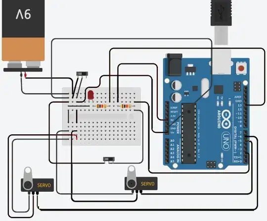

just want to give a back story first. So i saw this video on youtube about the useless box, and i thought that it would make a great gift for my 7 year old. So i went out and bought everything that the guy posted in his description box. Just want to say that i am very new to Arduino and how these things work. I actually just want to build this as a gift to my son. I know on Stack platforms that before you ask questions you need to try yourself, i have been trying to get this thing working for the past 36 hours, and im not getting anywhere.
So here is a list of the things i have tried so far.
  1. Firstly i bought everything exactly the same as what the guy had, imported it so i know its the same stuff.
  2. I downloaded the code and schematic.
  3. I wired the little board 4 times, to make sure i did it correctly.
  4. I have redrawn the schematic in tinkercad to make sure all the wires are going to the correct places.
Here is the link to my tinkercad drawing the code is in there as well. Please note that on tinkercad i cant get the arduino board not to be plugged in by usb, it is supposed to get power from the external power supply (4AA battries).
https://www.tinkercad.com/things/43WIrlmR1K3-project1
Here is a link to the youtube video: https://www.youtube.com/watch?v=cpdjQ0gheDQ&t=311s
Here is the schematic he provided:
enter image description here Here is the Code he provided:

So in my tinkercad when i run the simulation everything works (exept for the motors breaking but i know it because of the extra power its getting from the usb which i can turn off). When you look in the Serial Monitor it runs through all the "Actions" and when you simulate the button that gets pressed by the servo everthing stops and wait until you toggle the switch again and it goes to the next action.
I have done exactly the same and like i said i wired the board 4 times to make sure its exactly the same. When i switch on the project on my board the servos keep spinning and does not stop and wait for the switch, but when i toggle the switch it actually plays the next "Action", but in the times where it is suppose to wait or stop when the switch is in the off position the servos keep rotating looks like in an anti-clockwise rotation.
Please any help would be greatly appreciated. If you need more info or if anything is unclear please ask me to provide more and i will. I tried to make it as clear as possible. Thanks
PeterJoe
  • 53
Yes they turn 360
Normal servos turn between 0 and 180° (or a bit more or less). On these servos you can set the angle through Servo.write(). But if the servo spins 360° and more, it is a continuous rotation servo. Here the Servo.write() value sets the rotation speed, not the angle. A value of 90 let's it stand still. Values below 90 means rotation backwards, above 90 forward. The higher the distance from 90, the higher the rotation speed will be.
In the video the servos are mounted in a way, that they cannot spin 360°, so they must be normal servos (that also fits with the code). If your servos spin more, you unfortunately bought the wrong servo type.
The code sets the idle position of the boxservo to 70 and of the handservo to 180. That means, that with a continuous rotation servo both servos would spin in idle state, the handservo being way faster than the boxservo.
So you would need to buy normal servos for this project.
