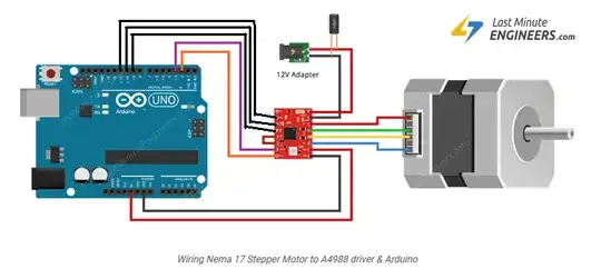

Edit - Added schematic of the electronics connections. Original image from www.lastminuteengineers.com
Schematic of the electronics connections. Original image from www.lastminuteengineers.com
