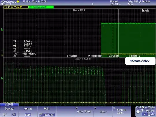

I expect the code to gradually increase the duty cycle of the signal and than slowly decrease. And that works! The problem is that i do not get a normal PWM signal out of it.
I've attached one of the previous test signals to this post, with a bit different code, to show the problem. The output signal

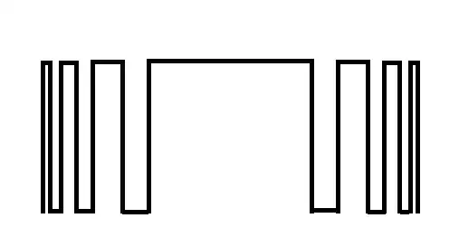

i've expected the pwm more clear like demonstrated in this paint picture: Expected result
How do I get from these spikes to a more normal block signal?
