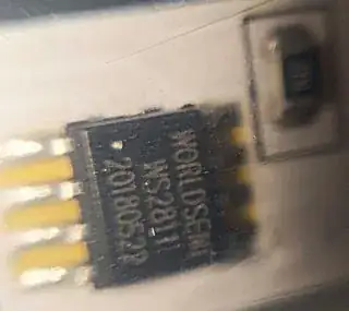

I have a 5 meter strip of 12V digital RGB LEDs. The chip is WS2811 (see photo of IC). There are 50 addresses on the strip.
WS2811 IC

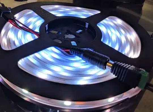

Using the FastLED library, I am able to run the "FirstLight" example that chases full white with a single address at a time, up and down the length. That works fine. So I know they individually perform properly.

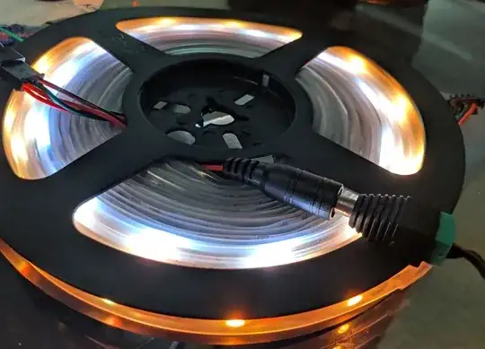

However, if I set all LEDs to full white (255), the first few addresses look white but then the higher the address, the more red it is. See photo below. The strip starts in the center of the reel.

To debug, I tried turning on just the last half. The result was still problematic: WS2811 last half
for (int i = 30; i < NUM_LEDS; i++) {
    leds[i] = CRGB::White;
I then tried setting all LEDs to white at half brightness, and that looks much better, but the LEDs at the outside are still off-color compared the inside: WS2811 white half brightness

I would suspect that it is a voltage drop in the power rails caused by the current draw. Probably cheap construction with copper tracks that are just too thin and so have too high a resistance.
To combat it you will need to inject power into the strip at various points along it. Initially to prove the theory you can try connecting the power to both ends of the strip and see if the "dull" spot is half way along the strip. If it is, then it's certainly a voltage drop. (incidentally, a voltage drop will cause the blue LEDs to fade out first making it go yellow-red. Then the green ones would probably be next, making it go red).
Then, once proved, you will need to add extra power connections into the strip at the middle of any dim sections and feed the voltage directly in at those points.

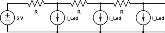

I then modeled the strip as a sequence of ideal current generators joined by resistors:
schematic
Calling R the resistance introduced by the strip, I_Led the current flowing into one LED and N the number of LEDs turned on (and ignoring the effects of the standby current), the voltage drop on the first resistor is dV1 = RNI_Led, the one on the second is dV2 = R*(N-1)I_Led and so on, up to dVN = RI_Led. The total voltage drop is dV = RN(N+1)*I_Led/2.
Using the measured data, we can calculate the resistance between two consecutive LEDs:
R = (2*dV)/(N*(N+1)*I_Led) = (2*0.64V) / (100*101*0.018A) = 7mOhm
NOTE: this is neglecting the effects of the standby current. However in my calculations I was searching for a worst case, and by excluding these effects I was in fact making worst assumptions, so I did not care about them
So, with this resistance I was able to calculate the voltage drop for arbitrary strips and consequently plan where to put the power supply joints. In my case I planned to have at max stubs 1.2m long (80 LEDs), so that the voltage at the end, in the very worst case (all LEDs on in RGBW, at max brightness), I had a voltage drop of slightly more than 1V.
Note that in my setup the voltage drop on the first element (the one with the largest drop) is (80*0.045A*0.007mOhm) = 25mV, with a power dissipation of 90mW.

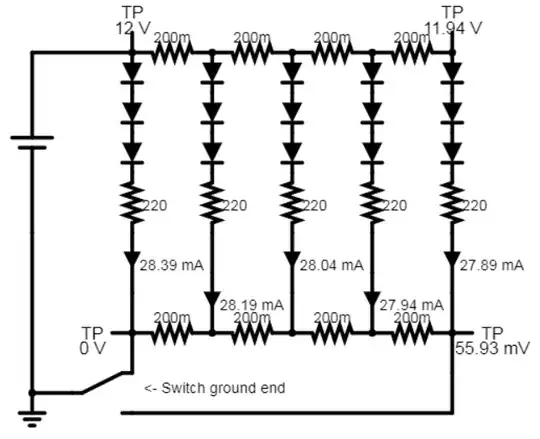

For completeness, I want to include an RGB circuit simulation I made a while ago, along with some data. It's for analog RGB strips, but the concept regarding voltage drop is the same. I've since added a few more LEDs to show the effect of voltage drop across the length, and added the ability to switch the power connection as well.
The simulation shows the current through each 3-LED segment. 12V strips typically have 3 LEDs in series, and repeat that along the strip.
When I created this simulation, I chose exaggerated resistance values, however, this WS2811 strip may be rather close. I haven't modeled it with particular measurements though.
There are switches in simulation circuit that you can click on to switch the connection to 12V and ground at either end of the strip.
[Link to simulation] 12V LED strip simulation
Results:
With 12V and ground on the same end:  28.389mA - 27.892mA = 2.123mA difference
With 12V and ground on both ends:        28.389mA - 27.892mA = 0.497mA difference
With 12V and ground on opposite ends: 27.310mA - 26.834mA = 0.476mA difference
While both power and ground can be connected at both ends of the strip, this simulation actually shows a better balance by simply moving the ground to the opposite end of the strip that receives 12V.
The only way for each LED segment to be truly balanced would be for each to have it's own connection to power and ground.
