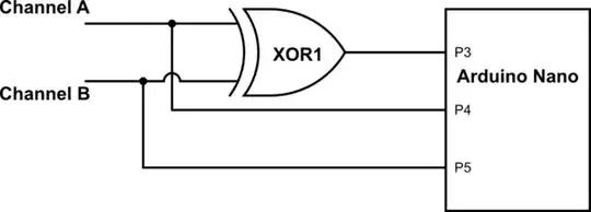

I want to read a quadrature rotary encoders at full resolution with only one interrupt on Arduino Nano (ATmega328). So I found out that we can use XOR to reach a full resolution:
Where pin 3 is interruptable but 4 and 5 are not.

This is just a partial, rushed answer.
You should be able to get a significant speed-up if you define your own ISR for handling the interrupt, as in:
ISR(INT1_vect) { ... }
The Arduino way of using interrupts is instead
void trigger() { ...}
    attachInterrupt(int_number, trigger, CHANGE);
but this is slow, as it involves the ISR provided by the Arduino core, which has to locate and call your interrupt handler. The way you wrote the handler is wrong: either you define a regular function, without the ISR macro, and go the Arduino way, or you go the plain AVR path and define the ISR yourself, which should be named INTERRUPT_NAME_vect, in which case you don't use attachInterrupt(). The way you did it is probably the slowest you can get, as the compiler will needlessly add an ISR-type prologue and epilogue to your handler.
As for the maximum frequency, that's hard to assess without testing, but you may get some idea by reading this answer on interrupt latency.
Edit: As I stated in my first comment to the question, a pin change interrupt can be used instead of an external logic gate. Here is how to do it.
First, one should look at the Arduino Uno pinout and see that:
  • digital 4 = PD4 = PCINT20
  • digital 5 = PD5 = PCINT21
Both pins are tied to the pin change interrupt request 2 (PCINT2_vect). This interrupt can be configured in setup() as follows:
PCMSK2 = _BV(PCINT20)   // enable interrupt on pin PCINT20 = PD4
       | _BV(PCINT21);  // enable interrupt on pin PCINT21 = PD5
PCIFR  = _BV(PCIF2);    // clear interrupt flag
PCICR  = _BV(PCIE2);    // enable pin change interrupt request 2
Now, the interrupt will fire on every change of the logic levels of inputs 4 and 5.
