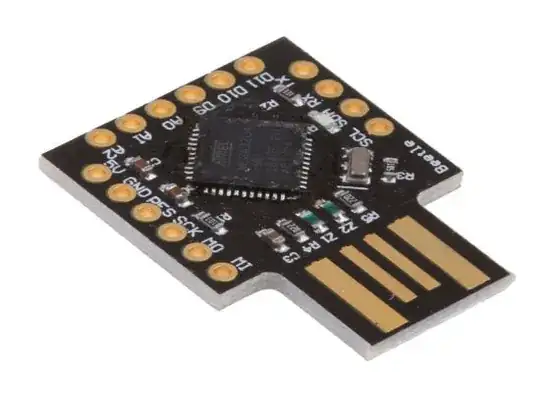

I have this board:
Arduino Leonardo Beetle mini board
It has the atmega32u4 chip.
I have updated its code several times, and used it without issues for several months. Today, while updating (using Arduino IDE) it started to throw some errors. At the end it said that the checksum didn't match, so I repeated again few more times with the same behavior until it reported "Uploaded" without errors. I used for few minutes and it was working as expected. Then, I had to do another update and the same happened (checksum didn't match). However this time I got to the point in which it was no longer detected by the OS (Ubuntu), and no LED is turning on.
Whenever I connect it to the USB port, I can only see in the logs:

UPDATE
I didn't realize that this board has a reset marked as "RES". Following Juraj recommendation I bridged RES and GND. The LED marked as "SDA" turns ON after I release the contact and I can read in the logs:
[1212051.679205] usb 1-9.4: USB disconnect, device number 22
[1212058.532030] usb 1-9.4: new full-speed USB device number 23 using xhci_hcd
[1212058.621972] usb 1-9.4: New USB device found, idVendor=2341, idProduct=0036
[1212058.621982] usb 1-9.4: New USB device strings: Mfr=2, Product=1, SerialNumber=0
[1212058.621988] usb 1-9.4: Product: Arduino Leonardo
[1212058.621994] usb 1-9.4: Manufacturer: Arduino LLC
[1212058.622933] cdc_acm 1-9.4:1.0: ttyACM0: USB ACM device
Which I think its good news. However, it seems ttyACM0 becomes available for few seconds. I was able to upload the Blink example into the chip and I can confirm its working because its blinking. Still the ttyACM0 disappears after few seconds.

lepe
  • 141
Probably you have overwritten your Bootloader.
Connect MOSI, MISO, SCK and RESET to an ISP-Programmer and flash the file Caterina-LilyPadUSB.hex to it.
There are lots of tutorials on the net how to use a spare arduino as an ISP-Programmer.
