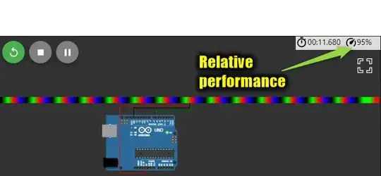

I work with the wokwi Arduino simulator
  • It is faster
  • It uses the latest Arduino IDE for compilation
  • It almost runs in real-time. For example, your job of 15 seconds might get executed at about the 17th or 20th second.
Please give it a try. here are some references enter image description here
Links: https://wokwi.com and https://wokwi.com/arduino/libraries enter image description here enter image description here
