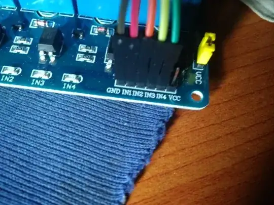

This is the relay board

Connecting the pins as stated below
VIN-->VCC D0--> IN1 D1--> IN2 D2-->IN3 D3-->IN4 Gnd-->Gnd
But only IN2,IN3 and IN4 led of relay board are only glowing the IN1 is not glowing and the relays are not switching on/off...
Anyone please help....
Please give any solution... Why the relays are not switch-on?
Please reply as soon as possible... I am very disturbed... Even cant sleep at night....
chrisl
  • 16,622
From the description and comments it looks like the problem is HW related. I recommend you to do a relay module test (wthout NodeMCU):
  1. Try to switch the relays on/off just by connecting the power source you are using for powering the NodeMCU. Connect VCC–5V, GND–GND and one of the IN channels directly to 5V pin. If the relay switches on, try another channel. If not, try to connect IN to GND instead of 5V (inverted logic).
  2. If 1. did not worked, check the yellow jumper on the right side of the relay board. The jumper must be attached (in case you don't want to use another independent power source just for relays).
  3. If 2. did not worked, check if the relay board is not intended for use with 12 V DC power source (check the relay marking).
At this point you should know if all channels of the relay module are working and also the switching logic (inverted/noninverted). The next step should be connecting the relay module to the NodeMCU and run a "blink" example for all channels. If all is working well, we will be sure the problem is NOT HW related...
