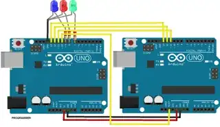

  • I used a Nano (loaded with "Arduino as ISP") as programmer for the Uno with this classical wiring (except that in my case, the left board, the programmer, is a Nano):

  • I used "Programmer: Arduino as ISP", then "Burn bootloader" then "Upload with programmer" with any sketch.
  • Then the fuses are programmed to Internal 8 Mhz, and we can take the ATmega328p out of the Uno and move it on a breadboard! Working now :)
