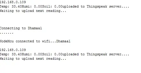

I am trying to connect my nodemcu client with nodemcu server, while my client is connected with two sensors (DHT11 and Soil Moisture) and it is workign perfectly, but on the server side I am unable to get all values, it is only giving me value of one parameter. Server Side Code

and the output of it is Server side output

Kindly help me to get all values at server side, Thanks

You use the same name value for all /update? parameters. And the format of url parameters is ?name1=value1&name2=value2
Use
String url = "/update?t=";
url += String(t);
String url1 = "&h=";
url1 += String(h);
String url2 = "&s=";
url2 += String(s);
send it as one GET request
and read server.arg("t"), server.arg("h") and server.arg("s").
Note 1: Sending more responses with serverSend to one request from browser has no effect. Only the first will work.
Note 2: this kind of use of String class will fragment the memory and cause a crash
Note 3: You don't need to use HTTP to communicate between your devices over TCP network. You can use simple TCP socket connections without HTTP protocol overhead.
