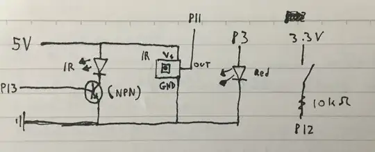

I am trying to use my Arduino Leonardo (or Uno!) as a remote with the IRRemote library. The current setup picks up and decodes a signal perfectly, but fails to retransmit it.
I have tested the infrared LED and it works.
I have tested the setup against a television IR receiver at very close range.
My board consists of:
board schematic
I am using the example IRRecord code (included below) with one change -- I made STATUS_PIN P3 (instead of P13), as I read that P13 is used to transmit IR signal on the Leonardo. I made this change after testing all PWM pins (including P3) for transmitting the IR signal. I'd appreciate any help to get this working.
I have also tried this on an Arduino Uno to no effect. This is driving me a little crazy!
Code below.
