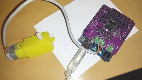

I have this Arduino motor shield which is hooked up with two DC motors. The board is the same as this one from Sparkfun.
A PWM output controls the speed of the motor, and a digital out controls the direction. The problem is that it only works in one direction, namely if the direction pin is high.
With the direction pin HIGH and 255 is written to the PWM pin, Vout on the terminals is similar to Vin. If I reverse the direction by setting the direction pin LOW I would expect Vout to be -Vin, ie. the polarity reversed. But not so. I get a little more than zero volt across the terminals.
It's the same for both channels.
Edit: The setup is powered from a 9V power adaptor through the barrel jack on Arduino.
Photo of the DC motor connected to the driver board
Is the board defective, or am I misunderstanding something?
SOLUTION: Thanks to the edited post (especially #3) in the accepted answer, I not only looked at the schematic (again), I actually understood it. I had already noticed the jumper called V-LOGIC which on the picture from Sparkfun was set to 5V where it on my shield was not set. I really didn't know what it was used for, but I set it to 5V so it was the same. But by looking at the schematic and the inverters, I realized that the inverter was fed from V-LOGIC which was connected to 5V. And bingo: I had not connected the 5V pin on the shield, only vIN which I assumed would be sufficient. The thing is, I am awaiting a set of stackable headers instead of the ones supplied, so I only connected the minimum numbers of pins because I will need to desolder them when I get the new headers.

I think you may be having an issue with how you are powering the shield. Are you trying to do it with just your USB connection?
In your photo, I do not see a connection to your Arduino's barrel jack or to the Vin connector of the shield itself. According to the SparkFun site:

EDIT BASED ON COMMENTS
Since you are properly powering the shield, I would recommend the following (see the shield's schematic for specifics):
  1. Maintaining the connection shown above (with the addition of the 9V power supply connected to the barrel jack) ensure that you are able to properly set the DIRA input. You can check this with a multimeter on pin 7 of the LN298 whenever you are trying to switch directions.
  2. If you are getting the expected results on pin 7 (pin goes HI when your code wants the motor to go one direction and pin goes LOW for the other) - check pin 9... the value here should always be the opposite of what you are setting for DIRA on pin 7. If that is all good, then you probably have an issue with the LN298.
  3. If you are not getting the expected results at pin 9, but pin 7 looks good, then you are having a problem with the 74HC1G04 IC (although I would doubt this since you are having problems with both the A and B motor outputs).
  4. If you are not getting the expected results at pin 7, then double check the code to make sure you have set and cleared the correct output pin. I would also check the solder joints of the connectors on the shield - you can set a multimeter to do a resistance check from the shield's connector (pin 12) to the direction input on the LN298 (pin 7). If the continuity is measuring close to 0 ohms then there is probably an issue with your code.
  5. If your code looks good, I have also had issues with bad outputs on the Arduino - you can check to see if you are properly toggling the direction pin (pin 12) on the Arduino without the shield connected. Then, if the pin is not toggling, there is probably an issue with your Arduino - try toggling a different (unused) pin and jumpering it.
