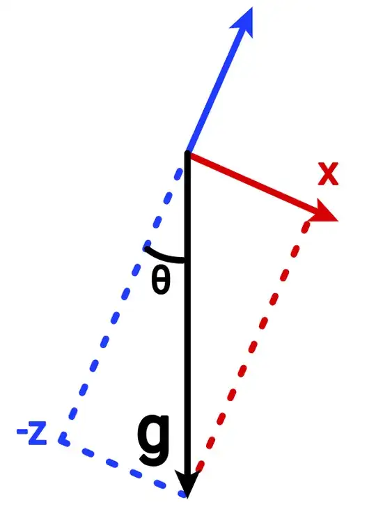

When the aircraft is moving at a constant velocity, the accelerometer just measures the acceleration due to gravity, which is a vector pointing exactly downward, (0, 0, -g) in the global coordinate system. This is always true, regardless of the orientation of the sensor.
If the sensor is perfectly level, the sensor's local coordinate system is aligned with the global coordinate system, so the sensor also measures (0, 0, -g).
When the sensor is tilted, the measured vector also has an x and y components.
To keep things simple, imagine the case where the sensor is tilted around the positive y axis.
The sensor now measures an x component as well as a z component: (x, 0, -z).
As you can see from the following image, the angle of rotation θ = atan2(x, z).
gravity acceleration vector The black arrow is the acceleration due to gravity, and the red and blue arrows are the x and z axes of the coordinate system of the (tilted) sensor.
