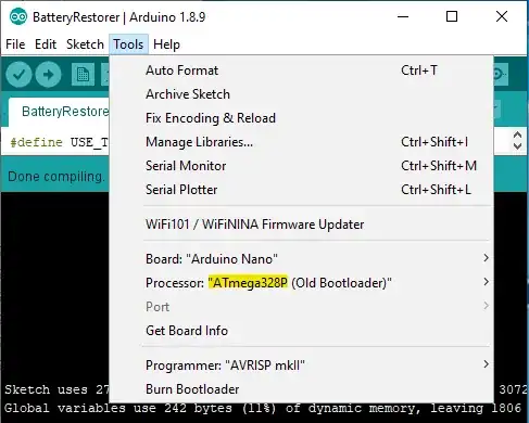

In my tests I used ATmega328P settings.
arduino board setting

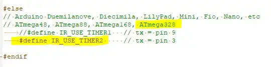

Edit C:\Users\youruser\Documents\Arduino\libraries\IRremote\boarddefs.h and look for your processor number.
For ATmega328 the definition is #define IR_USE_TIMER2
boarddefs.h code
I simply changed it to use #define IR_USE_TIMER1
boarddefs.h updated
And compilation was successfull.
