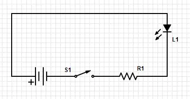

I'm new to Arduino and consequently, to circuits. I've been reading Arduino Robotics by Warren and this was a circuit present in the book.
From what Warren has said, electricity in the circuit travels from the negative pole to the positive, BUT to imagine it as going the other way for simplicity. So, looking at this circuit... it seems useless to have the resistor placed after the LED, based on the + --> - model. Wouldn't the LED turn on before going through the resistor, rendering the resistor useless?
Sorry if this seems like a basic concept, I'm entirely new to this.

The important thing to remember is that the direct current electricity must flow through the circuit to be useful. Since the resistor is part of the circuit (meaning that there isn't another path for the current to take) it resists the overall flow, thereby helping to protect the LED. Whether before or after the LED, it would still be in the circuit, and would therefore still reduce current flow.
Visualizing the Flow of Water
Think of it like a water hose, where the LED is a flow meter and the resistor is your foot. If you step on the hose before the flow meter it will cause the overall flow to slow down. Stepping on the hose after the flow meter but before the nozzle will have the same result, as the water must pass through the entire length of the hose before being released.
