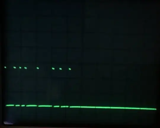

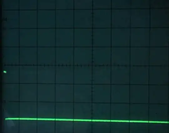

Here are two O'scope screen grabs. One shows the pulse train generated by a single button transition with a 50uSec delay, and the other shows the same switch with the 100mSec delay. In both photos, the horizontal time scale is 500uSec/cm
