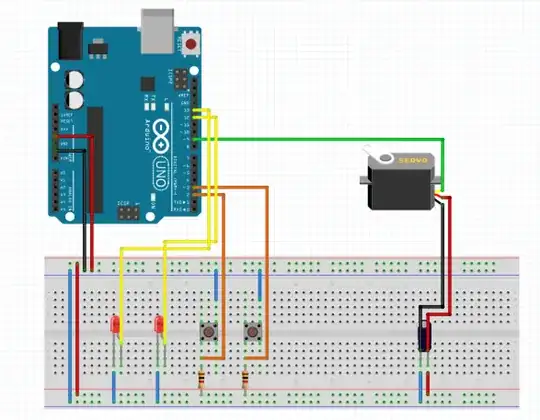

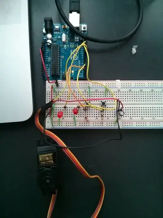

I've attached a photo of my project. What I am trying to do is create a box, where 4 pushbuttons sit in a box, with LEDs next to them. I will probably create foamboard cutouts for the spaces where the pushbuttons and leds sit. The wiring for the push buttons and the LEDs need to be hidden below the foam board, along with the arduino itself and the servo motor - which is where I get stuck.
What do I need to do to essentially "lengthen" the wires for the pushbuttons and LEDs, and make sure all the components stay secure in the breadboard (the push buttons in particular like to pop out)? Is there a way to do this without making a PCB? I understand the concept of soldering components into protoboard, but as far as cutting / printing the circuits or whatever, it is really confusing to me.
I'd appreciate any guidance. If you see anything wrong with my wiring setup too, I'd love a learning experience on that as well. Thanks!

As for the circuit itself, you can get rid of the pullup resistors on the switches if you use internal pullups instead. And 100ohm is way too low a value for switch pullups regardless.

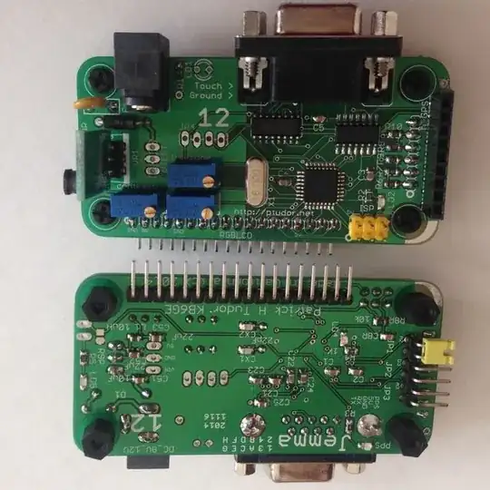

Learning to design a PCB can be a challenge. First, there's software choices, there's file formats, and then actually laying out a good board. That's before production and assembly, each with its own struggles along the way. It's no different than the first time you open Xcode and learn about Storyboards and Frameworks and Simulators and all that, or for that matter, learning any new skill, which at first is a daunting experience but through both setbacks and success eventually becomes easy.

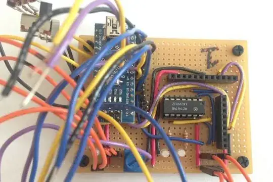

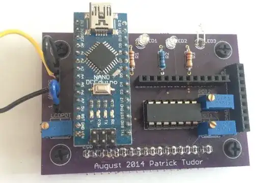

So, I agree with everyone that suggests perfboards and variants. But I also want to show, as perhaps motivation, where you could be in a few months. I tend to see Arduinos as the development tool, not the final product, but I understand others are content to just use a standalone Nano or Pro Mini and forever dedicate it to their project.
These are three variants of the same device, it combines an Arduino/ATMega, a GPS, a serial port, and an RGB LCD. I first created it in on a breadboard, then moved to a perfboard, thought "that is ugly" and made a simple PCB. Pleased with that experience, I kept refining the schematic and layout until I finally called the project "done."
perfboard project primitive PCB Final PCB

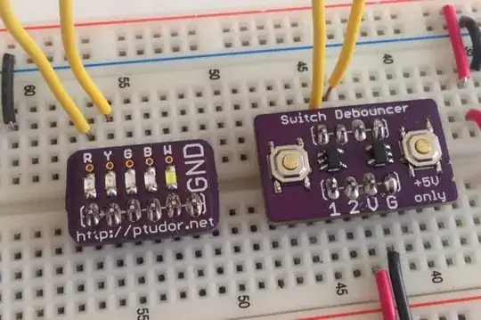

You also might consider making tiny PCBs just for specific components, like these two boards I make for buttons and lights.
hardware switch denouncer and LED breakout boards
The very first PCB I ordered from OSHPark was an amazing experience, opening the envelope and holding it like some religious relic. But since then it's become routine. If you do later go the PCB route, you might appreciate my summary of low-volume shops I've ordered from.

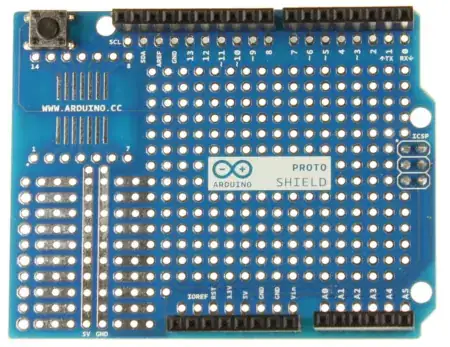

You can use Arduino proto shield. It's a prototyping board shaped the way it can be plugged into the Arduino. There are over 9000 of them from different manufacturers. Then just solder the stuff you need on the proto shield.
