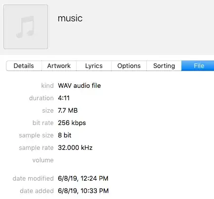

Everything is good when I play this tmrpcm.play("music.mp3"); but the others I hear aliens sounds expect this tmrpcm.play("200.wav"); which I can hear the number two hundred but I feel the sound is 4-bit depth which very noisy. The files used in the code are here
For clarification previously, I thought it was amplifying issues which then I had to used LM386 but the sound was the same noise with tmrpcm.play("200.wav"); and later when I tried this tmrpcm.play("music.mp3"); I was shocked it worked perfectly like what I need it to be! so I was curious I removed the LM386 and played this tmrpcm.play("music.mp3"); again and worked alright just maybe less volume.

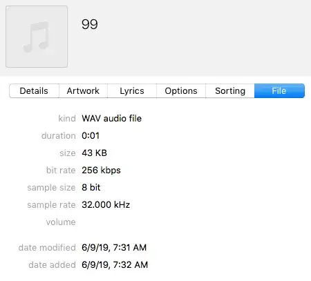

As @Juraj mentioned it was solved by changing the setting and I was able easily to play the sound when I matched the setting to this file:
So, I could not create one from scratch matches above setting but I was able to convert existing sound through this site which allowed me to convert with desire setting and here finally the exiting sound has matched the setting:
