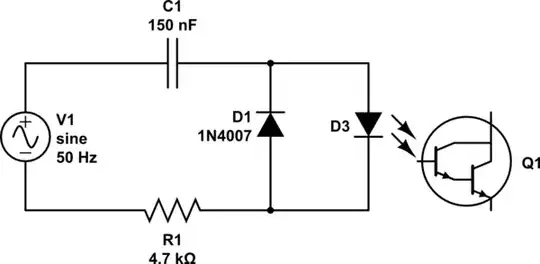

There's certainly an issue with your optocoupler circuit aside from the fluctuation you observe.
During a negative half-wave of 220V, you expect D1 to block the current through the LED. However, 1N4007 as any power rectifier has significant leakage current, about 5μA at normal temperature and up to 50μA when the diode is hot. This current will go though the LED which may have a much lower admissible reverse current (typical 0.1μA), damaging it. One possible schematic would be:
schematic
Note that D1 is here not to block reverse current, but rather conduct it safely, protecting the LED of the optocoupler. Also, consider reducing the value of R2 while realising the bulk of current limitation with a non-polar capacitor: this setup will limit the current just the same but will dissipate 0.5W of heat instead of 2W as your resistor would.
Now, in either case the LED is only active when it's forwad-biased, which is less than half of the time, so it's quite normal that you see this fluctuation. In most cases, it can be reasonably dealt with by software: read your pin 3 times with a 5ms delay after each reading, and make a logical AND of your three readings.
If, for some reason you cannot do that in software, you could implement an envelope detector in hardware. I strongly suggest to do it on the low-voltage side instead of 220V side (as e.g. here)
