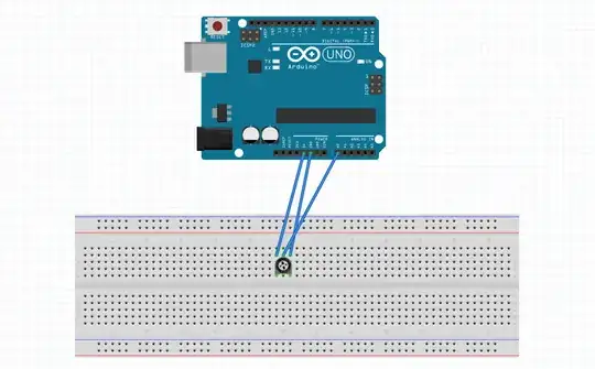

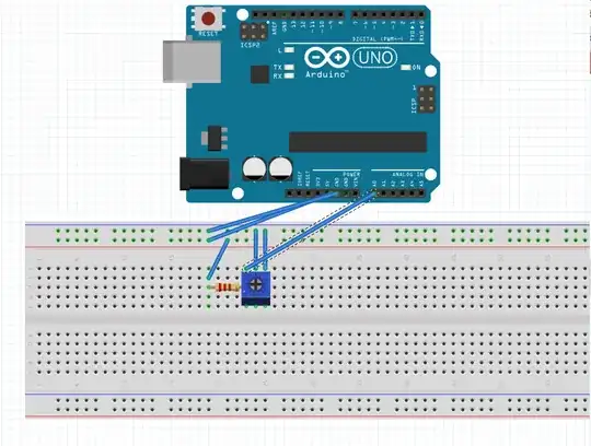

I am trying to read voltage using analogRead in Arduino Uno from a voltage divider circuit consisting of 1k resistor and 10k pot. The Pot used is bourns 3296. The values obtained only range from 1011 to 1023? Why is the count not reducing further if I rotate the pot?
(this how i have connected the circuit, but the pot is the one that i have mentioned above, i couldn't find that kind in the software, but i have made the connection this way only) this how i have connected the circuit, but the pot is the one that i have mentioned above, i couldn't find that kind in the software, but i have made the connection this way only

Since potentiometer itself is a voltage divider, I have tried connecting as per the answer, the ends of the 10k pot to 5V and ground , and the slider pin to the analog pin A0. The new circuit is as shown below, but I am still unable to get the value ranging from 0 to 1023. The values returned only vary in between 1010 to 1023. What is going wrong? How do I get the full range? pot interfacing with arduino uno

A potentiometer is already a voltage divider by itself. The outer contacts are connected to the ends of a resistor strip. The middle pin is connected to a wiper, which can slider over the strip, dividing the strip into 2 parts. So you connect it like it is described at the start of your sketch (before the last edit): The outer pins to 5V and ground respectively and the middle pin to the analog input. (When using this in different circuits, keep in mind, that you should not draw too much current from the middle pin. Don't drive any load directly from it. The analog input does only draw a very small amount, so that's absolutely no problem.)
When adding a constant resistor in series with the pot, you are only adding a dead range, that cannot be set with the circuit.

Your pot MAY be broken. Measure the resistance of the pot with an ohm meter, from the center pin to either of the side pins. Verify when you turn it the resistance varies from 10K to 0.
You can also measure the voltage it is providing your Arduino by measuring the voltage it presents to pin A0. Verify the voltage changes little by little from +5 to 0 when you turn it back and forth.
You list the pot as being a "bourns 3296" which the data sheets show as a "Multiturn / Cermet / Industrial / Sealed" pot.
Just so you know, when you adjust it you will have to turn it 25 turnes to fully adjust it through its entire range. The data sheet shows "Effective Travel.........25 turns nom."
