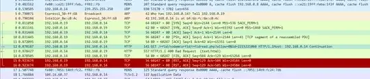

This program is a program which readings of rfid are saved to myphp database. I have a problem when running the code The wifi is connected but when the code doesn't save im assuming that the problem is in this part of the code client.print("GET /rfid/nodemcu_rfid/rfid_read.php?allow="); Since i have done a wire shark capture and notice a Bad Request error 400 as shown in the screen shot. enter image description here
IP Addresses: 192.168.0.14 Is the php server , 192.168.0.19 is the nodemcu

Your problem is here:
client.print(" ");      //SPACE BEFORE HTTP/1.1
client.print("HTTP/1.1");
client.print("Host: ");
 client.println(server);
client.println("Host: 192.168.0.14");//eg: 192.168.0.222
client.println("Connection: close");
client.println();
That ends up with:
....(your request)... HTTP/1.1Host: 192.168.0.14
Host: 193.168.0.14
Connection: close
Not only are you sending the Host header twice, but you're not adding the line ending after the HTTP version.
Instead it should look more like:
client.println("HTTP/1.1"); // <-- Note the use of println not print
client.println();
