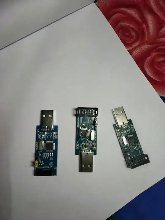

I have tried different three other Usbasp but still same error
Different USPasp
