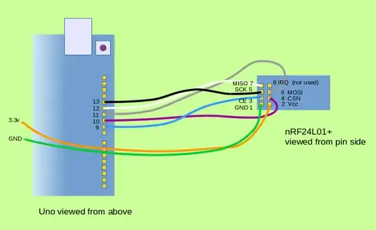

Hardware Connections: Hardware Connections

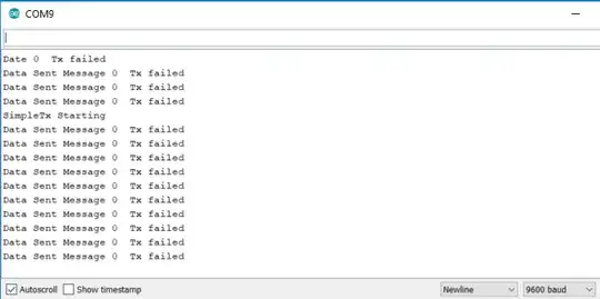

Serial monitor:

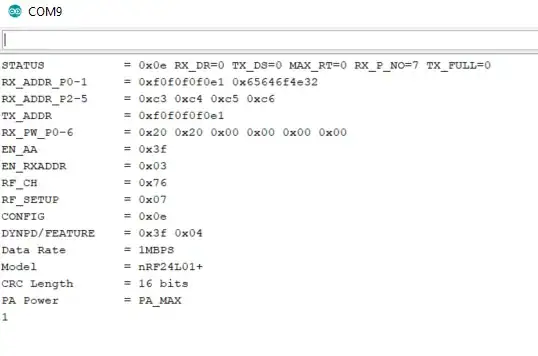

Using radio.printDetails( ); returns:

The Arduinos 3V3 does not privide enough current. To eliminate this as a source of your problem you can use a ceramic capacitor of 100µF across VCC and GND pins of the nRF24L01+ module or buy a 5V to 3V3 step down converter specially made for nRF24L01.
